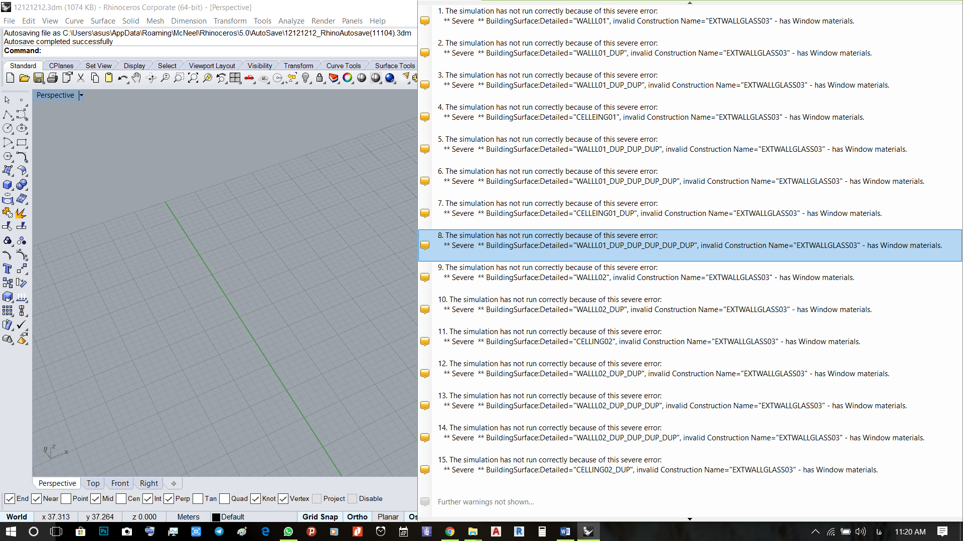

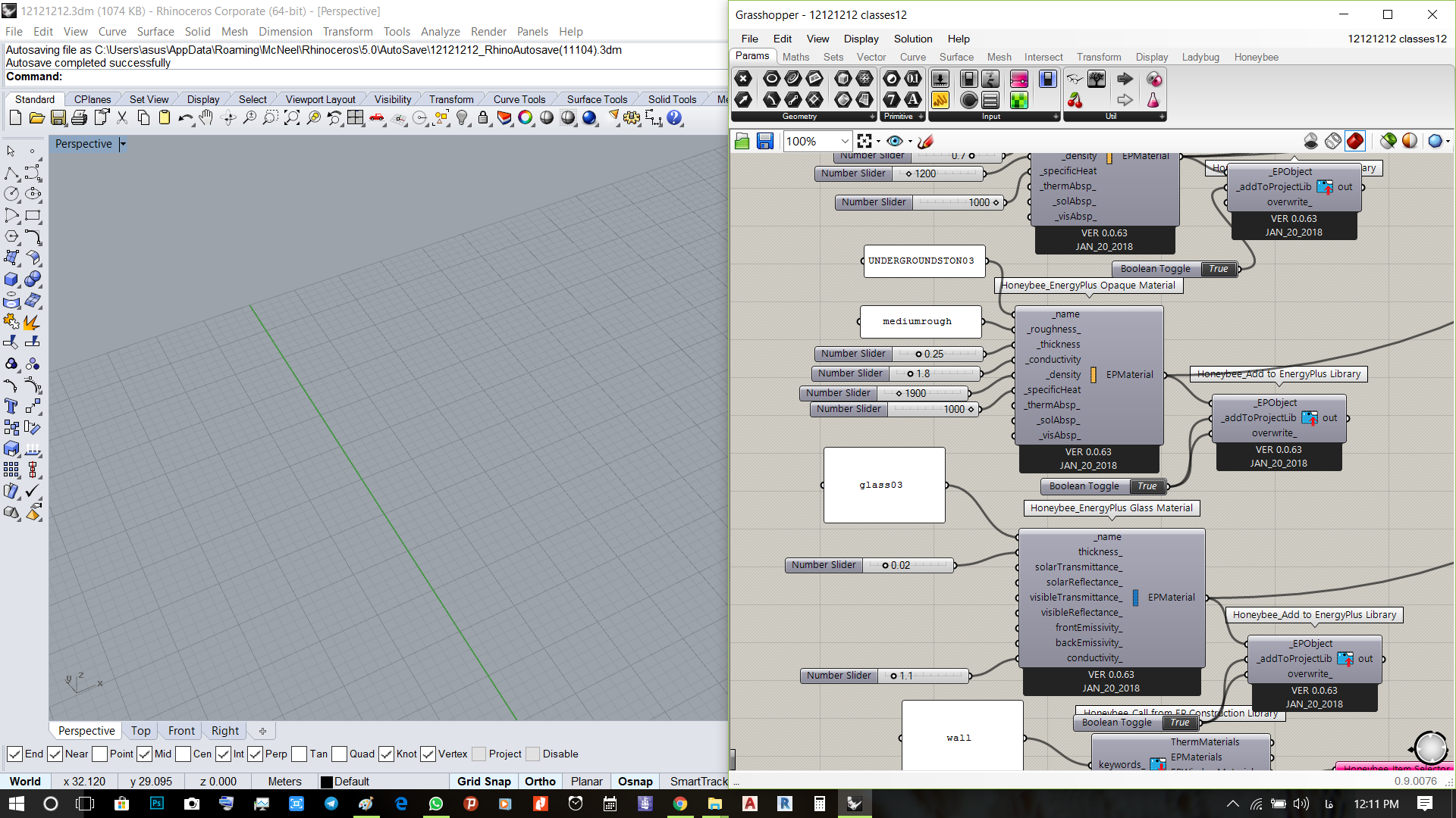

من دیوار گلخونه ام که تمام شیشه است رو با کامپوننت EP glass material ساختم ولی انرژی پلاس ارور میده میگه این برای پنجره است . چکاری برای رفع این ارور کنم؟ البته دیوار شیشه ایه من ا لایه هست
11 پاسخ

120. Program Version,EnergyPlus, Version 8.5.0-c87e61b44b, YMD=2020.07.30 17:40,IDD_Version 8.5.0
121.
122.    ** Warning ** IP: Note -- Some missing fields have been filled with defaults. See the audit output file for details.
123.
124.    ************* Beginning Zone Sizing Calculations
125.
126.    ** Warning ** GetHTSurfaceData: Surfaces with interface to Ground found but no "Ground Temperatures" were input.
127.
128.    **   ~~~   ** Found first in surface=OFFIC1_SRF_4
129.
130.    **   ~~~   ** Defaults, constant throughout the year of (18.0) will be used.
131.
132.    ** Severe  ** BuildingSurface:Detailed="WALLL01", invalid Construction Name="EXTWALLGLASS03" - has Window materials.
133.
134.    **   ~~~   ** ...because Surface Type=WALL
135.
136.    ** Severe  ** BuildingSurface:Detailed="WALLL01_DUP", invalid Construction Name="EXTWALLGLASS03" - has Window materials.
137.
138.    **   ~~~   ** ...because Surface Type=WALL
139.
140.    ** Severe  ** BuildingSurface:Detailed="WALLL01_DUP_DUP", invalid Construction Name="EXTWALLGLASS03" - has Window materials.
141.
142.    **   ~~~   ** ...because Surface Type=WALL
143.
144.    ** Severe  ** BuildingSurface:Detailed="WALLL01_DUP_DUP_DUP_DUP", invalid Construction Name="EXTWALLGLASS03" - has Window materials.
145.
146.    **   ~~~   ** ...because Surface Type=ROOF
147.
148.    ** Severe  ** BuildingSurface:Detailed="WALLL01_DUP_DUP_DUP_DUP_DUP", invalid Construction Name="EXTWALLGLASS03" - has Window materials.
149.
150.    **   ~~~   ** ...because Surface Type=WALL
151.
152.    ** Severe  ** BuildingSurface:Detailed="WALLL01_DUP_DUP_DUP_DUP_DUP_DUP", invalid Construction Name="EXTWALLGLASS03" - has Window materials.
153.
154.    **   ~~~   ** ...because Surface Type=WALL
155.
156.    ** Severe  ** BuildingSurface:Detailed="WALLL01_DUP_DUP_DUP_DUP_DUP_DUP_DUP_DUP", invalid Construction Name="EXTWALLGLASS03" - has Window materials.
157.
158.    **   ~~~   ** ...because Surface Type=ROOF
159.

سارا عبادی سارا عبادی
آقای دکتر من بالا ارسال کردم براتون severe error هارو که دومدل ارور هست
شما 600 خط متن ارور فرستادید طیعتا من هم چک نخواهم کرد .. لطفا از ارور عکس بفرستید ..
درسته. من عکسش رو ارسال کردم خدمتتون.
الان بیشتر ارورها برمیگرده به متریالی که برای پنجره ها تعریف کردید.. اونارو چک کنید ..
درسته همینه . فقط من دیوارهای شیشه ای رو با این متریال دادم چون میخاستم یک جدار شیشه ای برای گلخونه داشته باشم و نمیخاستم پنجره باشه تا تهویه داشته باشم. ولی ارور میگه که این متریال برای پنجره هست . الان من نمیدونم که چطور باید دیوار شیشه ایم رو متریال بدم
من دیوار شیشه ایم رو با add glass material  دادم مشکل فک میکنم اینه ولی نمیدونم چطور حلش کنم
شما باید بک مقدار از کناره ها فاصله بزارید .. کل دیوار نمیتونه شیشه باشه .. درثانی باید window ep constructionتعریف کنید .. نه ep material .. بیشتر از این نمیشه اینجا راهنمایی کرد .. فیلم اموزشی رو مجدد ببینید اگر تهیه کردید
خوب کاملا اشتباهه این روش.
